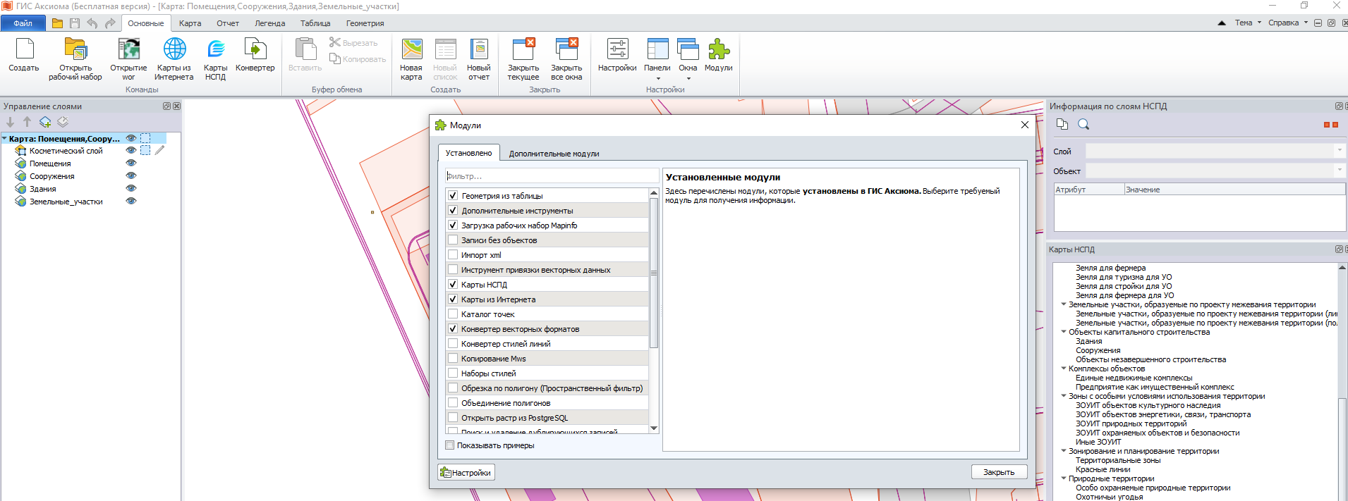

Модуль НСПД установлен, но при его активации возникает ошибка:
Модули
<b>Не удалось запустить модуль</b>
Проблемы с модулем ru_axioma_gis_axipy_rosreestr.
File "C:\Program Files\Axioma v7\bin\python\Lib\site-packages\axipy\_internal\_plugin_utils.py", line 58, in _load_plugin
module = load_plugin_dir(plugin_dir)
File "C:\Program Files\Axioma v7\bin\python\Lib\site-packages\axipy\_internal\_plugin_utils.py", line 55, in load_plugin_dir
loader.exec_module(module_arg)
File "<frozen importlib._bootstrap_external>", line 843, in exec_module
File "<frozen importlib._bootstrap>", line 219, in _call_with_frames_removed
File "C:\Users\UstyugovEV\AppData\Roaming\ESTI\Axioma.GIS\v7\installed_modules\modules\ru_axioma_gis_axipy_rosreestr\__init__.py", line 9, in <module>
from .info import NSPDInfo
File "C:\Program Files\Axioma v7\bin\python\Lib\site-packages\shiboken2\files.dir\shibokensupport\feature.py", line 139, in _import
return original_import(name, *args, **kwargs)
File "C:\Users\UstyugovEV\AppData\Roaming\ESTI\Axioma.GIS\v7\installed_modules\modules\ru_axioma_gis_axipy_rosreestr\info\__init__.py", line 1, in <module>
from .nspd_info import NSPDInfo
File "C:\Users\UstyugovEV\AppData\Roaming\ESTI\Axioma.GIS\v7\installed_modules\modules\ru_axioma_gis_axipy_rosreestr\info\nspd_info.py", line 13, in <module>
from .data_model import DataModel
File "C:\Users\UstyugovEV\AppData\Roaming\ESTI\Axioma.GIS\v7\installed_modules\modules\ru_axioma_gis_axipy_rosreestr\info\data_model.py", line 14, in <module>
from .web_service import web_service
File "C:\Users\UstyugovEV\AppData\Roaming\ESTI\Axioma.GIS\v7\installed_modules\modules\ru_axioma_gis_axipy_rosreestr\info\web_service.py", line 12, in <module>
from .async_http_client import AsyncHttpClient
File "C:\Users\UstyugovEV\AppData\Roaming\ESTI\Axioma.GIS\v7\installed_modules\modules\ru_axioma_gis_axipy_rosreestr\info\async_http_client.py", line 11, in <module>
import aiohttp
ModuleNotFoundError: No module named 'aiohttp'
Подскажите пожалуйста, что нужно сделать, чтобы он активировался?
Сообщения: 712
Re: Карты НСПД
Сообщение Александр » 09 сен 2025, 13:51
Тут похожая проблема: https://forum.axioma-gis.ru/viewtopic.php?f=5&t=4265#p7112
Попробуйте выполнить рекомендации: https://forum.axioma-gis.ru/viewtopic.php?f=5&t=4265&start=10#p7118
А если не поможет, то: https://forum.axioma-gis.ru/viewtopic.php?f=5&t=4265&start=10#p7120

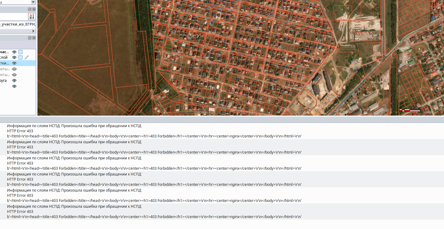

Модуль НСПД подключен и обновлен до версии 1.5. Однако при попытках получить информацию об объекте идет бесконечная загрузка и информация не появляется. Подскажите пожалуйста с чем это может быть связано?
Сообщения: 712
Re: Карты НСПД
Сообщение Александр » 10 сен 2025, 12:06
Проблема с бесконечной загрузкой может быть вызвана несколькими причинами:
1. Особенности текущей версии модуля — модуль НСПД версии 1.5 пока находится в стадии тестовой эксплуатации, и в нём возможны временные технические ограничения или ошибки.
2. Влияние антивирусного ПО — иногда антивирусы блокируют взаимодействие с внешними сервисами.
3. Изменения на стороне сервиса НСПД — возможны временные сбои или обновления на стороне самого сервиса, с которым работает модуль.
Рекомендуем начать с простого решения:
  1. Закройте Аксиому полностью.
  2. Запустите её и повторите попытку получения информации об объекте.
Пожалуйста, сообщите нам о результате — это поможет нам точнее определить причину и предложить дальнейшие шаги для устранения проблемы. Если ошибка сохранится — мы обязательно поможем разобраться глубже.
Спасибо за понимание.
Евгений_
Сообщения: 3
Зарегистрирован: 09 сен 2025, 11:09
Re: Карты НСПД
Сообщение Евгений_ » 10 сен 2025, 13:51
Александр писал(а): 10 сен 2025, 12:06 Проблема с бесконечной загрузкой может быть вызвана несколькими причинами:
Не помогло, вчера, сегодня утром и сейчас
